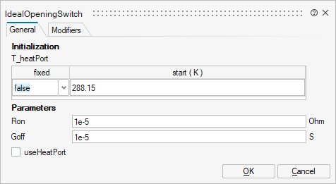

The switching behaviour of the ideal opening switch is controlled by the input signal control: off = control.
For further details, see partial model IdealSwitch.
mo_T_heatPort | T_heatPort | T_heatPort | Structure | |
mo_T_heatPort/fixed | fixed | Cell of scalars | true | |
mo_T_heatPort/start | start | Cell of scalars | ||
mo_Ron | Ron | Closed switch resistance | Scalar | |
mo_Goff | Goff | Opened switch conductance | Scalar | |
mo_T | T | Fixed device temperature if useHeatPort = false | Scalar |

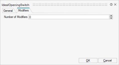

mo__modifiers/varname | Variable name | Cell of strings | 'v' | |
mo__modifiers/value | Value |
