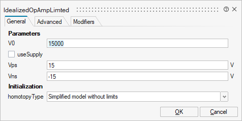

Supply voltage is either defined by parameter Vps and Vns or by (optional) pins s_p and s_n.
In the first case the necessary power is drawn from an implicit internal supply, in the second case from the external supply.
mo_V0 | V0 | No-load amplification | Scalar | |
mo_useSupply | useSupply | Use supply pins (otherwise constant supply) | Number | 0 |
mo_Vps | Vps | Positive supply voltage | Scalar | |
mo_Vns | Vns | Negative supply voltage | Scalar | |
mo_homotopyType | homotopyType | Simplified model for homotopy-based initialization | Structure | |
mo_homotopyType/choice1 | Homotopy is not used | Number | 0 | |
mo_homotopyType/choice2 | Simplified model without limits | Number | 0 | |
mo_homotopyType/choice3 | Simplified model fixed at upper limit | Number | 0 | |
mo_homotopyType/choice4 | Simplified model fixed at lower limit | Number | 0 |

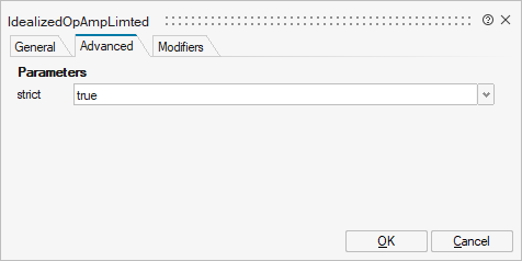

mo_strict | strict | = true, if strict limits with noEvent(..) | Scalar | true |

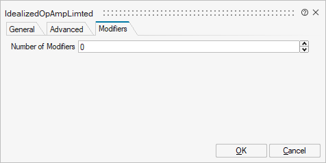

mo__modifiers/varname | Variable name | Cell of strings | 'vps' | |
mo__modifiers/value | Value |
