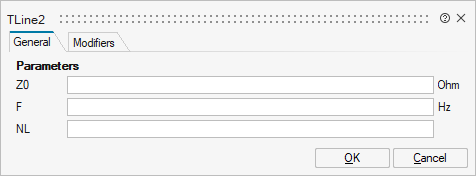

mo_Z0 | Z0 | Characteristic impedance | Scalar | |
mo_F | F | Frequency | Scalar | |
mo_NL | NL | Normalized length | Scalar | |
mo_TD | TD | Scalar |

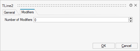

mo__modifiers/varname | Variable name | Cell of strings | 'v1' | |
mo__modifiers/value | Value |
