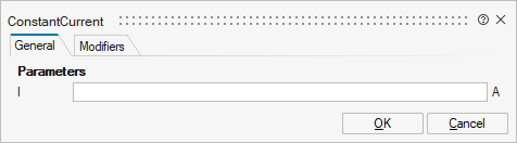

The ConstantCurrent source is a simple source for an ideal constant current which is provided by a parameter. There is no internal resistance modeled. No further effects are modeled. Especially, the current flow will never end.
mo_I | I | Value of constant current | Scalar |

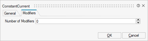

mo__modifiers/varname | Variable name | Cell of strings | 'v' | |
mo__modifiers/value | Value |
