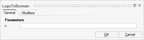

If the signal width is greater than 1 this conversion is done for each signal.

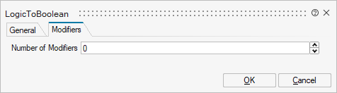

mo_n | n | signal width | Scalar |
mo__modifiers/value | Value |
