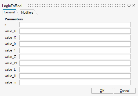

Conversion of a digital input into a Real output without any delay according to:
input output 'U' (coded by 1) val_U 'X' (coded by 2) val_X '0' (coded by 3) val_0 '1' (coded by 4) val_1 'Z' (coded by 5) val_Z 'W' (coded by 6) val_W 'L' (coded by 7) val_L 'H' (coded by 8) val_H '-' (coded by 9) val_m
The values val... are given by parameters.
If the signal width is greater than 1 this conversion is done for each signal.
mo_n | n | signal width | Scalar | |
mo_value_U | value_U | value for digital U (uninitialized) | Scalar | |
mo_value_X | value_X | value for digital X (Forcing Unknown) | Scalar | |
mo_value_0 | value_0 | value for digital 0 (Forcing 0) | Scalar | |
mo_value_1 | value_1 | value for digital 1 (Forcing 1) | Scalar | |
mo_value_Z | value_Z | value for digital Z (High Impedance) | Scalar | |
mo_value_W | value_W | value for digital W (Weak Unknown) | Scalar | |
mo_value_L | value_L | value for digital L (Weak 0) | Scalar | |
mo_value_H | value_H | value for digital H (Weak 1) | Scalar | |
mo_value_m | value_m | value for digital m (Do not care) | Scalar |

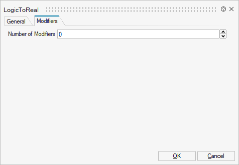

mo__modifiers/value | Value |
