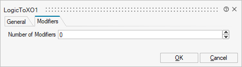

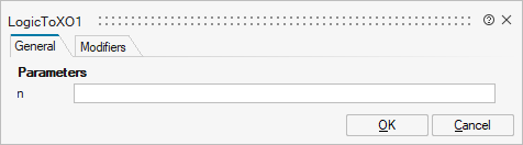

mo_n | n | signal width | Scalar |
mo__modifiers/value | Value |
x | implicit | input | 1 | |
y | implicit | output | 1 |
