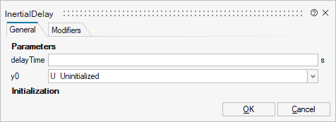

Provides the input as output delayed by delayTime if the input holds its value for a longer time than delayTime.If time is less than delayTime the initial value y0 holds.
mo_delayTime | delayTime | Minimum time to hold value | Scalar | |
mo_y0 | y0 | Initial value of output y | Structure | |
mo_y0/choice1 | U Uninitialized | Number | 0 | |
mo_y0/choice2 | X Forcing Unknown | Number | 0 | |
mo_y0/choice3 | 0 Forcing 0 | Number | 0 | |
mo_y0/choice4 | 1 Forcing 1 | Number | 0 | |
mo_y0/choice5 | Z High Impedance | Number | 0 | |
mo_y0/choice6 | W Weak Unknown | Number | 0 | |
mo_y0/choice7 | L Weak 0 | Number | 0 | |
mo_y0/choice8 | H Weak 1 | Number | 0 | |
mo_y0/choice9 | - Do not care | Number | 0 | |

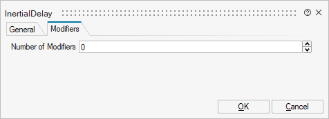

mo__modifiers/value | Value |
