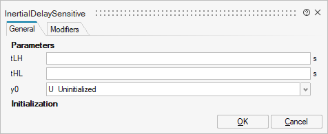

The delay Tdel depends on the values of the signal change. To calculate Tdel, the DelayTable specified inDigital.Tables is used. If the corresponding value is 1, then tLH is used, if it is -1, then tHLis used, if it is zero, the input is not delayed.
mo_tLH | tLH | rise inertial delay | Scalar | |
mo_tHL | tHL | fall inertial delay | Scalar | |
mo_y0 | y0 | initial value of output | Structure | |
mo_y0/choice1 | U Uninitialized | Number | 0 | |
mo_y0/choice2 | X Forcing Unknown | Number | 0 | |
mo_y0/choice3 | 0 Forcing 0 | Number | 0 | |
mo_y0/choice4 | 1 Forcing 1 | Number | 0 | |
mo_y0/choice5 | Z High Impedance | Number | 0 | |
mo_y0/choice6 | W Weak Unknown | Number | 0 | |
mo_y0/choice7 | L Weak 0 | Number | 0 | |
mo_y0/choice8 | H Weak 1 | Number | 0 | |
mo_y0/choice9 | - Do not care | Number | 0 | |

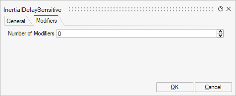

mo__modifiers/varname | Variable name | Cell of strings | 'delayTime' | |
mo__modifiers/value | Value |
