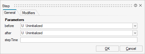

The step source output signal steps from the value before to the value afterat the time stepTime.

If the logic values are imported by
import L = Digital.Interfaces.Logic;
they can be used to specify the parameter, e.g., L.'0' for forcing 0.
mo_before | before | Logic value before step | Structure | |
mo_before/choice1 | U Uninitialized | Number | 0 | |
mo_before/choice2 | X Forcing Unknown | Number | 0 | |
mo_before/choice3 | 0 Forcing 0 | Number | 0 | |
mo_before/choice4 | 1 Forcing 1 | Number | 0 | |
mo_before/choice5 | Z High Impedance | Number | 0 | |
mo_before/choice6 | W Weak Unknown | Number | 0 | |
mo_before/choice7 | L Weak 0 | Number | 0 | |
mo_before/choice8 | H Weak 1 | Number | 0 | |
mo_before/choice9 | - Do not care | Number | 0 | |
mo_after | after | Logic value after step | Structure | |
mo_after/choice1 | U Uninitialized | Number | 0 | |
mo_after/choice2 | X Forcing Unknown | Number | 0 | |
mo_after/choice3 | 0 Forcing 0 | Number | 0 | |
mo_after/choice4 | 1 Forcing 1 | Number | 0 | |
mo_after/choice5 | Z High Impedance | Number | 0 | |
mo_after/choice6 | W Weak Unknown | Number | 0 | |
mo_after/choice7 | L Weak 0 | Number | 0 | |
mo_after/choice8 | H Weak 1 | Number | 0 | |
mo_after/choice9 | - Do not care | Number | 0 | |

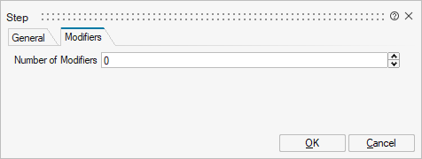

mo_stepTime | stepTime | step time | Scalar |
mo__modifiers/value | Value |
