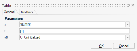

If the logic values are imported by
import L = Digital.Interfaces.Logic;
they can be used to specify the parameter, e.g., L.'0' for forcing 0.
mo_x | x | vector of values | FromModelica('Modelica.Electrical.Digital.Interfaces.Logic.''U''') | |
mo_t | t | vector of corresponding time points | Vector | |
mo_y0 | y0 | initial output value | Structure | |
