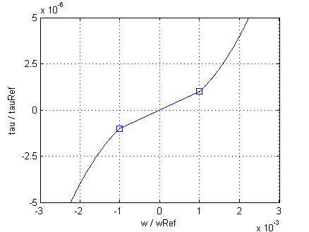

For stability reasons the friction torque tau is approximated by a linear curve
tau / tauLinear = w / wLinear
with
tauLinear = tauRef*(wLinear/wRef) ^ power_w
in the range -wLinear ≤ w ≤ wLinear with wLinear = 0.001 * wRef. The relationship of torqueand angular velocity is depicted in Fig. 1
Fig. 1: Friction loss torque versus angular velocity for power_w = 2 |

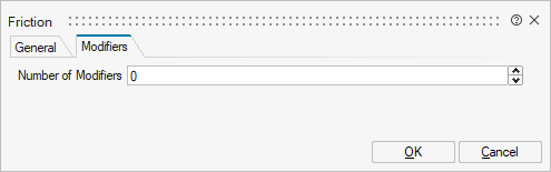

mo__modifiers/varname | Variable name | Cell of strings | 'phi' | |
mo__modifiers/value | Value |

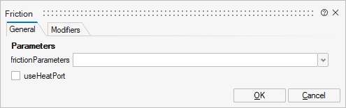

flange | implicit | Shaft end | input | 1 |
support | implicit | Housing and support | input | 2 |
Port 3 | implicit | Optional port to which dissipated losses are transported in form of heat | input | mo_useHeatPort |
