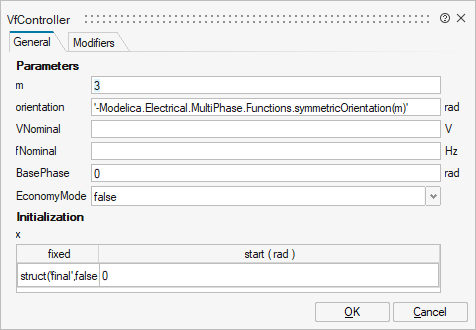

mo_nout | nout | Number of outputs | Scalar | |
mo_orientation | orientation | Orientation of phases | Vector | |
mo_VNominal | VNominal | Nominal RMS voltage per phase | Scalar | |
mo_fNominal | fNominal | Nominal frequency | Scalar | |
mo_BasePhase | BasePhase | Common phase shift | Scalar | |
mo_EconomyMode | EconomyMode | Economy mode: voltage quadratic dependent on frquency | Scalar | true |
mo_pow | pow | Scalar | ||
mo_x | x | x | Structure | |
mo_x/fixed | fixed | Cell of scalars | true | |
mo_x/start | start | Cell of scalars |

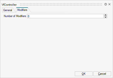

mo__modifiers/varname | Variable name | Cell of strings | 'amplitude' | |
mo__modifiers/value | Value |
