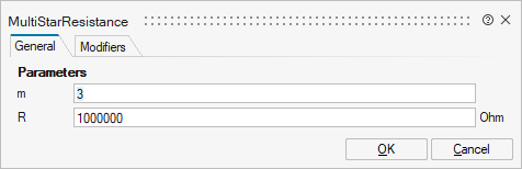

Multi star points are connected by resistors. This model is required to operate multi phase systems with even phase numbers to avoid ideal connections of start points of base systems; seemulti phase guidelines.
mo_mBasic | mBasic | Number of symmetric base systems | Scalar | |
mo_R | R | Insulation resistance between base systems | Scalar |

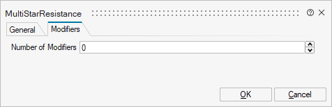

mo__modifiers/value | Value |
