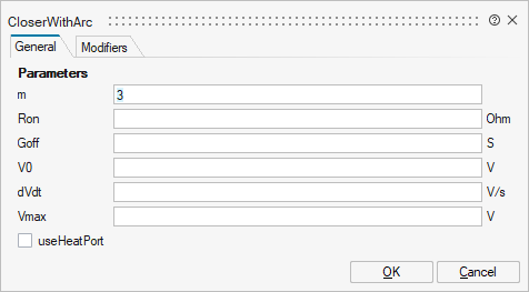

CloserWithArc
Multiphase closer with arc
Modelica/Electrical/MultiPhase/Ideal
Contains m closing switches with arc (Modelica.Electrical.Analog.Ideal.CloserWithArc).
mo_Ron | Ron | Closed switch resistance | Vector | |
mo_Goff | Goff | Opened switch conductance | Vector | |
mo_V0 | V0 | Initial arc voltage | Vector | |
mo_dVdt | dVdt | Arc voltage slope | Vector | |
mo_Vmax | Vmax | Max. arc voltage | Vector | |
mo_mh | mh | Number of heatPorts=number of phases | Scalar | |
mo_useHeatPort | useHeatPort | =true, if all heat ports are enabled | Number | 0 |
mo_T | T | Fixed device temperatures if useHeatPort = false | Vector |
mo__modifiers/varname | Variable name | Cell of strings | 'v' | |
mo__modifiers/value | Value |
plug_p | implicit | Positive polyphase electrical plug with m pins | input | 1 |
plug_n | implicit | Negative polyphase electrical plug with m pins | output | 1 |
control | implicit | true => switch open, false => p--n connected | input | 2 |
Port 4 | implicit | Conditional heat ports | input | mo_useHeatPort |
