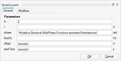

Contains m sine current sources (Modelica.Electrical.Analog.Sources.SineCurrent)with a default phase shift determined bysymmetricOrientation.
mo_I | I | Amplitudes of sine waves | Vector | |
mo_phase | phase | Phases of sine waves | Vector | |
mo_freqHz | freqHz | Frequencies of sine waves | Vector | |
mo_offset | offset | Current offsets | Vector | |
mo_startTime | startTime | Time offsets | Vector |
