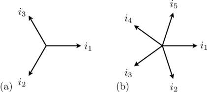

Symmetrical three phase system
A symmetrical three phases system consists of three sinusoidal sine waves with an angular displacement of 2 π / 3.
Symmetrical multi phase system
In symmetrical multi phase systems odd and even phase numbers have to be distinguished.
Odd number of phases
For a symmetrical multi phase system with m phases the displacement of the sine waves is 2 π / m.

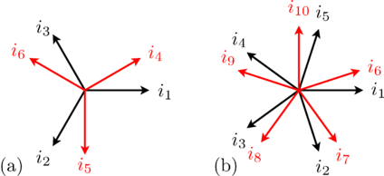

Even number of phases
In case of an even number of phases the aligned orientation does not add any information. Instead the m phases are divided into two or more different groups (the base systems).
The number of phases m can be divided by 2 recursively until the result is either an odd number or 2. The result of this division is called mBase, the number of phases of the base system.The number of base systems nBase is defined by the number of divisions, i.e., m = nBase * mBase.
For a base system with mBase phases the displacement of the sine waves belonging to that base system is 2 π / mBase.
The displacement of the base systems is defined as π / nBase.
Note
In array or matrices, the base systems are stored one after another.
