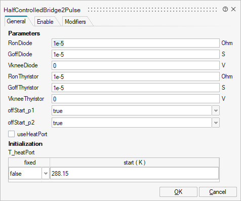

mo_RonDiode | RonDiode | Closed diode resistance | Scalar | |
mo_GoffDiode | GoffDiode | Opened diode conductance | Scalar | |
mo_VkneeDiode | VkneeDiode | Diode forward threshold voltage | Scalar | |
mo_RonThyristor | RonThyristor | Closed thyristor resistance | Scalar | |
mo_GoffThyristor | GoffThyristor | Opened thyristor conductance | Scalar | |
mo_VkneeThyristor | VkneeThyristor | Thyristor forward threshold voltage | Scalar | |
mo_offStart_p1 | offStart_p1 | Boolean start value of variable thyristor_p1.off | Scalar | true |
mo_offStart_p2 | offStart_p2 | Boolean start value of variable thyristor_p2.off | Scalar | true |
mo_T | T | Fixed device temperature if useHeatPort = false | Scalar | |
mo_T_heatPort | T_heatPort | T_heatPort | Structure | |
mo_T_heatPort/fixed | fixed | Cell of scalars | true | |
mo_T_heatPort/start | start | Cell of scalars |

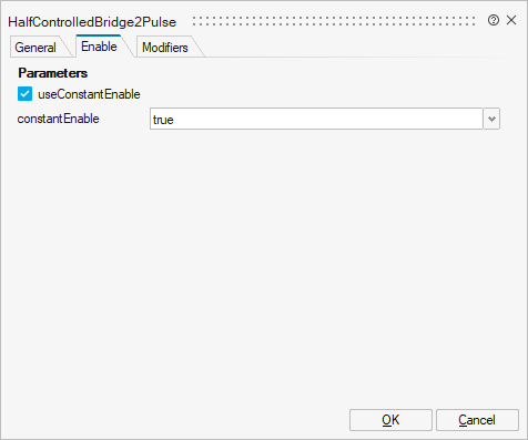

mo_useConstantEnable | useConstantEnable | true = disabled boolean input, use constantEnable | Number | 0 |
mo_constantEnable | constantEnable | Constant enabling of firing signals | Scalar | true |

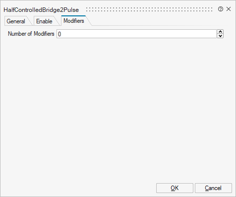

mo__modifiers/varname | Variable name | Cell of strings | 'vAC' | |
mo__modifiers/value | Value |
