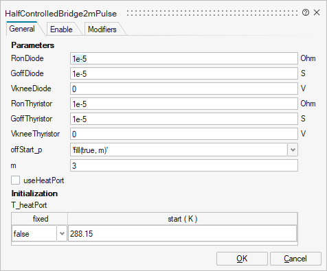

This is a 2*m pulse half controlled rectifier bridge. In order to operate this rectifier a voltage source with center tap is required. The circuit topology is the same as inExamples.ACDC.RectifierBridge2mPulse. It is important to note that for multi phase circuits with even phase numbers greater than three theMultiStarResistance shall be used for grounding the voltage sources.
mo_RonDiode | RonDiode | Closed diode resistance | Scalar | |
mo_GoffDiode | GoffDiode | Opened diode conductance | Scalar | |
mo_VkneeDiode | VkneeDiode | Diode forward threshold voltage | Scalar | |
mo_RonThyristor | RonThyristor | Closed thyristor resistance | Scalar | |
mo_GoffThyristor | GoffThyristor | Opened thyristor conductance | Scalar | |
mo_VkneeThyristor | VkneeThyristor | Thyristor forward threshold voltage | Scalar | |
mo_offStart_p | offStart_p | Boolean start value of variable thyristor_p[:].off | Vector | true |

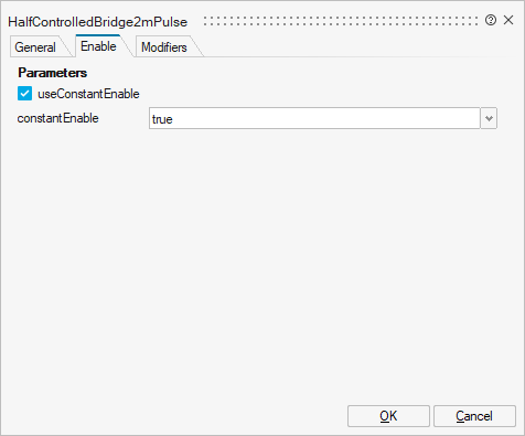

mo_useConstantEnable | useConstantEnable | true = disabled boolean input, use constantEnable | Number | 0 |
mo_constantEnable | constantEnable | Constant enabling of firing signals | Scalar | true |

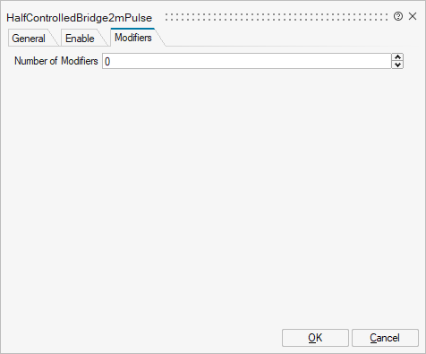

mo__modifiers/varname | Variable name | Cell of strings | 'vAC' | |
mo__modifiers/value | Value |
