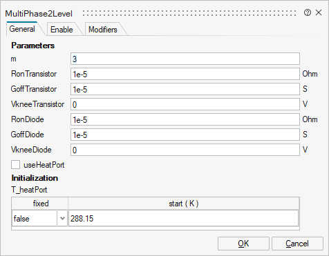

mo_RonTransistor | RonTransistor | Transistor closed resistance | Scalar | |
mo_GoffTransistor | GoffTransistor | Transistor opened conductance | Scalar | |
mo_VkneeTransistor | VkneeTransistor | Transistor threshold voltage | Scalar | |
mo_RonDiode | RonDiode | Diode closed resistance | Scalar | |
mo_GoffDiode | GoffDiode | Diode opened conductance | Scalar | |
mo_VkneeDiode | VkneeDiode | Diode threshold voltage | Scalar | |
mo_T | T | Fixed device temperature if useHeatPort = false | Scalar | |
mo_T_heatPort | T_heatPort | T_heatPort | Structure | |
mo_T_heatPort/fixed | fixed | Cell of scalars | true | |
mo_T_heatPort/start | start | Cell of scalars |

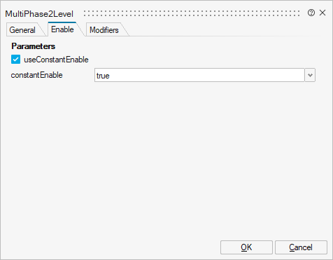

mo_useConstantEnable | useConstantEnable | true = disabled boolean input, use constantEnable | Number | 0 |
mo_constantEnable | constantEnable | Constant enabling of firing signals | Scalar | true |

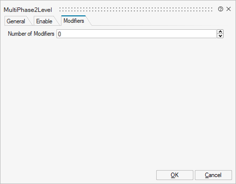

mo__modifiers/varname | Variable name | Cell of strings | 'vDC' | |
mo__modifiers/value | Value |
