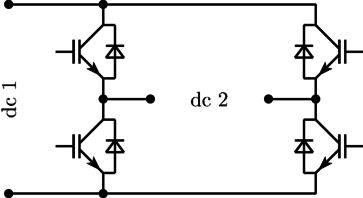

The H bridge is a four quadrant DC/DC converter. It consists of two single phase DC/AC converters which are controlled differently; see Fig. 1.
If the firing inputs fire_p and fire_n are inverse, the two legs are controlled symmetrically so that full positive or negative output voltage can be generated. See examplesDCDC.HBridge.

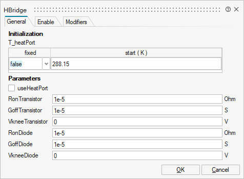

mo_T_heatPort | T_heatPort | T_heatPort | Structure | |
mo_T_heatPort/fixed | fixed | Cell of scalars | true | |
mo_T_heatPort/start | start | Cell of scalars | ||
mo_T | T | Fixed device temperature if useHeatPort = false | Scalar | |
mo_RonTransistor | RonTransistor | Transistor closed resistance | Scalar | |
mo_GoffTransistor | GoffTransistor | Transistor opened conductance | Scalar | |
mo_VkneeTransistor | VkneeTransistor | Transistor threshold voltage | Scalar | |
mo_RonDiode | RonDiode | Diode closed resistance | Scalar | |
mo_GoffDiode | GoffDiode | Diode opened conductance | Scalar | |
mo_VkneeDiode | VkneeDiode | Diode threshold voltage | Scalar | |
mo_m | m | Number of phases | Scalar |

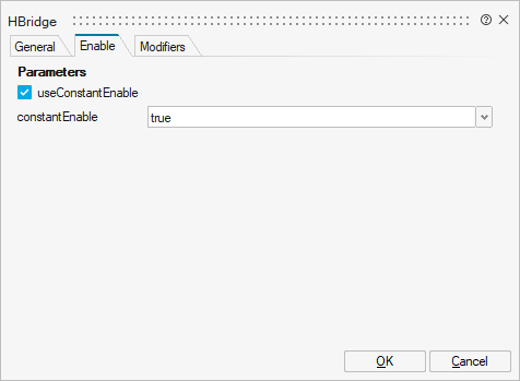

mo_useConstantEnable | useConstantEnable | true = disabled boolean input, use constantEnable | Number | 0 |
mo_constantEnable | constantEnable | Constant enabling of firing signals | Scalar | true |

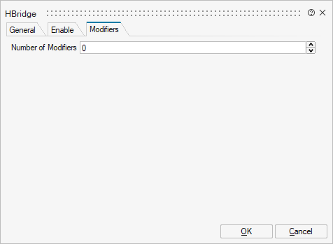

mo__modifiers/varname | Variable name | Cell of strings | 'vDC1' | |
mo__modifiers/value | Value |
