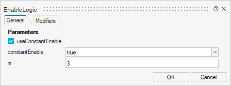

This model provides an internal enable signal derived either from a parameter or an optional signal input.For useConstantEnable = true the internal signal internalEnable is equal to the parameter constantEnable.For useConstantEnable = false the internal signalinternalEnable is equal to the external signal input enable.
mo_useConstantEnable | useConstantEnable | true = disabled boolean input, use constantEnable | Number | 0 |
mo_constantEnable | constantEnable | Constant enabling of firing signals | Scalar | true |
