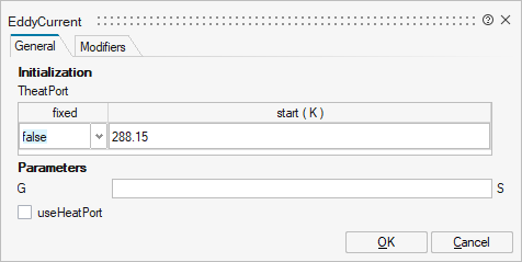

mo_TheatPort | TheatPort | TheatPort | Structure | |
mo_TheatPort/fixed | fixed | Cell of scalars | true | |
mo_TheatPort/start | start | Cell of scalars | ||
mo_G | G | Equivalent symmetric loss conductance | Scalar | |
mo_T | T | Fixed device temperature if useHeatPort = false | Scalar |

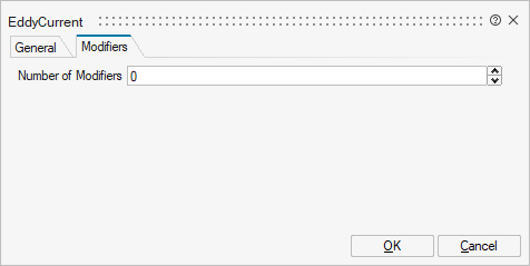

mo__modifiers/varname | Variable name | Cell of strings | 'abs_V_m' | |
mo__modifiers/value | Value |
