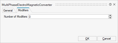

mo_effectiveTurns | effectiveTurns | Effective number of turns | Vector | |
mo_orientation | orientation | Orientation of the resulting fundamental wave field phasor | Vector |
mo__modifiers/varname | Variable name | Cell of strings | 'v' | |
mo__modifiers/value | Value |
