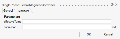

mo_effectiveTurns | effectiveTurns | Effective number of turns | Scalar | |
mo_orientation | orientation | Orientation of the resulting fundamental wave V_m phasor | Scalar | |
mo_N | N | Complex number of turns | Scalar |

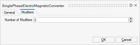

mo__modifiers/varname | Variable name | Cell of strings | 'v' | |
mo__modifiers/value | Value |
