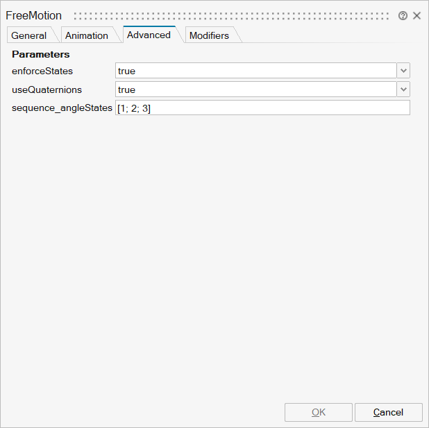

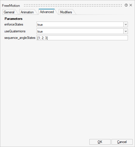

- If parameter useQuaternions in the "Advanced" menu is true (this is the default), then 4 quaternions are states. Additionally, the coordinates of the relative angular velocity vector are 3 potential states.
If useQuaternions in the "Advanced" menu is false, then 3 angles and the derivatives of these angles are potential states. The orientation of frame_b is computed by rotating frame_a along the axes defined in parameter vector "sequence_angleStates" (default = {1,2,3}, i.e., the Cardan angle sequence) around the angles used as states. For example, the default is to rotate the x-axis of frame_a around angles[1], the new y-axis around angles[2] and the new z-axis around angles[3], arriving at frame_b.
The quaternions have the slight disadvantage that there is anon-linear constraint equation between the 4 quaternions.Therefore, at least one non-linear equation has to be solvedduring simulation. A tool might, however, analytically solve thissimple constraint equation. Using the 3 angles as states has thedisadvantage that there is a singular configuration in which adivision by zero will occur. If it is possible to determine in advancefor an application class that this singular configuration is outsideof the operating region, the 3 angles might be used asstates by setting useQuaternions = false.
In text books about 3-dimensional mechanics often 3 angles and theangular velocity are used as states. This is not the case here, since3 angles and their derivatives are used as states(if useQuaternions = false). The reasonis that for real-time simulation the discretization formula of theintegrator might be "inlined" and solved together with the model equations.By appropriate symbolic transformation the performance isdrastically increased if angles and theirderivatives are used as states, instead of angles and the angularvelocity.
If parameterenforceStates is set to true (= the default)in the "Advanced" menu,then FreeMotion variables are forced to be used as states accordingto the setting of parameters "useQuaternions" and"sequence_angleStates".

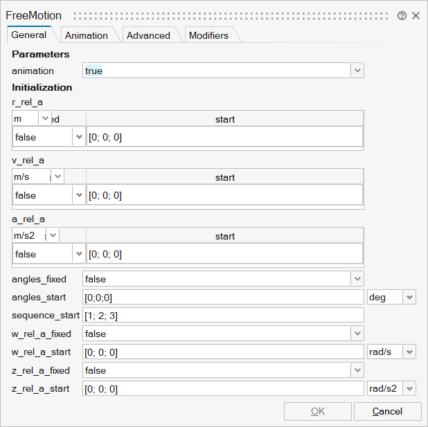

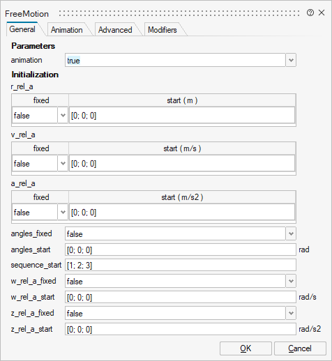

mo_animation | animation | = true, if animation shall be enabled (show arrow from frame_a to frame_b) | Scalar | true |
mo_R_rel_start | R_rel_start | Orientation object from frame_a to frame_b at initial time | FromModelica('Modelica.Mechanics.MultiBody.Frames.Orientation') | |
mo_Q_start | Q_start | Quaternion orientation object from frame_a to frame_b at initial time | Vector of size 4 | |
mo_phi_start | phi_start | Potential angle states at initial time | Vector of size 3 | |
mo_r_rel_a | r_rel_a | r_rel_a | Structure | |
mo_r_rel_a/fixed | fixed | Cell of vectors of size 3 | true | |
mo_r_rel_a/start | start | Cell of vectors of size 3 | ||
mo_v_rel_a | v_rel_a | v_rel_a | Structure | |
mo_v_rel_a/fixed | fixed | Cell of vectors of size 3 | true | |
mo_v_rel_a/start | start | Cell of vectors of size 3 | ||
mo_a_rel_a | a_rel_a | a_rel_a | Structure | |
mo_a_rel_a/fixed | fixed | Cell of vectors of size 3 | true | |
mo_a_rel_a/start | start | Cell of vectors of size 3 | ||
mo_angles_fixed | angles_fixed | = true, if angles_start are used as initial values, else as guess values | Scalar | true |
mo_angles_start | angles_start | Initial values of angles to rotate frame_a around 'sequence_start' axes into frame_b | Vector of size 3 | |
mo_sequence_start | sequence_start | Sequence of rotations to rotate frame_a into frame_b at initial time | Vector of size 3 | |
mo_w_rel_a_fixed | w_rel_a_fixed | = true, if w_rel_a_start are used as initial values, else as guess values | Scalar | true |
mo_w_rel_a_start | w_rel_a_start | Initial values of angular velocity of frame_b with respect to frame_a, resolved in frame_a | Vector of size 3 | |
mo_z_rel_a_fixed | z_rel_a_fixed | = true, if z_rel_a_start are used as initial values, else as guess values | Scalar | true |
mo_z_rel_a_start | z_rel_a_start | Initial values of angular acceleration z_rel_a = der(w_rel_a) | Vector of size 3 | |
mo_Q | Q | Q | Structure | |
mo_Q/fixed | fixed | Cell of vectors of size 4 | true | |
mo_Q/start | start | Cell of vectors of size 4 | ||
mo_phi | phi | phi | Structure | |
mo_phi/fixed | fixed | Cell of vectors of size 3 | true | |
mo_phi/start | start | Cell of vectors of size 3 | ||
mo_w_rel_b | w_rel_b | w_rel_b | Structure | |
mo_w_rel_b/fixed | fixed | Cell of vectors of size 3 | true | |
mo_w_rel_b/start | start | Cell of vectors of size 3 |

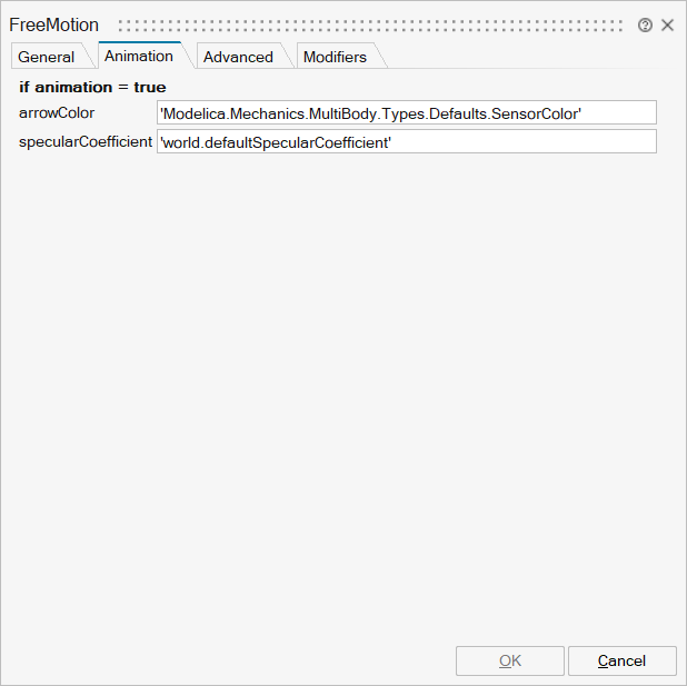

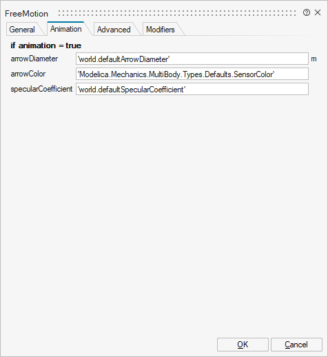

mo_arrowDiameter | arrowDiameter | Diameter of arrow from frame_a to frame_b | Scalar | |
mo_arrowColor | arrowColor | Color of arrow | Vector of size 3 | |
mo_specularCoefficient | specularCoefficient | Reflection of ambient light (= 0: light is completely absorbed) | Scalar |
mo_enforceStates | enforceStates | = true, if relative variables between frame_a and frame_b shall be used as states | Scalar | true |
mo_useQuaternions | useQuaternions | = true, if quaternions shall be used as states otherwise use 3 angles as states | Scalar | true |
mo_sequence_angleStates | sequence_angleStates | Sequence of rotations to rotate frame_a into frame_b around the 3 angles used as states | Vector of size 3 |

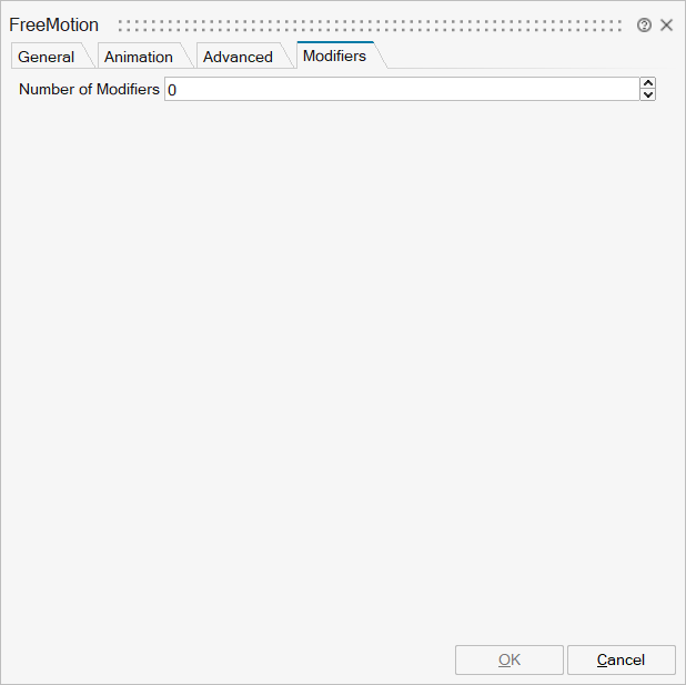

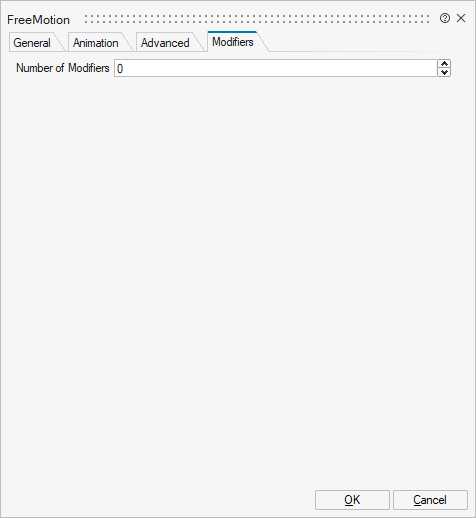

mo__modifiers/varname | Variable name | Cell of strings | 'phi_d' | |
mo__modifiers/value | Value |
