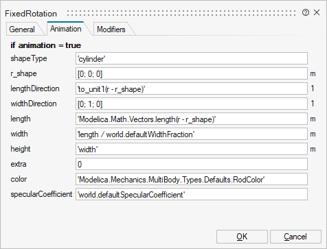

By default, this component is visualized by a cylinder connectingframe_a and frame_b, as shown in the figure below. In this figureframe_b is rotated along the z-axis of frame_a with 60 degree. Note, that thetwo visualized frames are not part of the component animation and thatthe animation may be switched off via parameter animation = false.

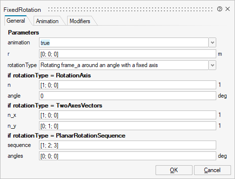

mo_animation | animation | = true, if animation shall be enabled | Scalar | true |
mo_r | r | Vector from frame_a to frame_b resolved in frame_a | Vector of size 3 | |
mo_rotationType | rotationType | Type of rotation description | Structure | |
mo_rotationType/choice1 | Rotating frame_a around an angle with a fixed axis | Number | 0 | |
mo_rotationType/choice2 | Resolve two vectors of frame_b in frame_a | Number | 0 | |
mo_rotationType/choice3 | Planar rotation sequence | Number | 0 | |
mo_R_rel | R_rel | Fixed rotation object from frame_a to frame_b | FromModelica('Modelica.Mechanics.MultiBody.Frames.Orientation') | |
mo_R_rel_inv | R_rel_inv | Inverse of R_rel (rotate from frame_b to frame_a) | FromModelica('Modelica.Mechanics.MultiBody.Frames.Orientation') | |
mo_n | n | Axis of rotation in frame_a (= same as in frame_b) | Vector of size 3 | |
mo_angle | angle | Angle to rotate frame_a around axis n into frame_b | Scalar | |
mo_n_x | n_x | Vector along x-axis of frame_b resolved in frame_a | Vector of size 3 | |
mo_n_y | n_y | Vector along y-axis of frame_b resolved in frame_a | Vector of size 3 | |
mo_sequence | sequence | Sequence of rotations | Vector of size 3 | |
mo_angles | angles | Rotation angles around the axes defined in 'sequence' | Vector of size 3 |
mo_shapeType | shapeType | Type of shape | String | |
mo_r_shape | r_shape | Vector from frame_a to shape origin, resolved in frame_a | Vector of size 3 | |
mo_lengthDirection | lengthDirection | Vector in length direction of shape, resolved in frame_a | Vector of size 3 | |
mo_widthDirection | widthDirection | Vector in width direction of shape, resolved in frame_a | Vector of size 3 | |
mo_length | length | Length of shape | Scalar | |
mo_width | width | Width of shape | Scalar | |
mo_height | height | Height of shape | Scalar | |
mo_extra | extra | Additional parameter depending on shapeType (see docu of Visualizers.Advanced.Shape) | Scalar | |
mo_color | color | Color of shape | Vector of size 3 | |
mo_specularCoefficient | specularCoefficient | Reflection of ambient light (= 0: light is completely absorbed) | Scalar |

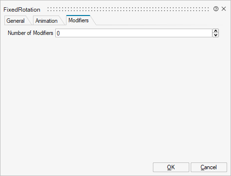

mo__modifiers/value | Value |
