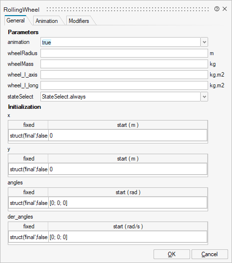

mo_animation | animation | = true, if animation of wheel shall be enabled | Scalar | true |
mo_wheelRadius | wheelRadius | Radius of wheel | Scalar | |
mo_wheelMass | wheelMass | Mass of wheel | Scalar | |
mo_wheel_I_axis | wheel_I_axis | Inertia along the wheel axis | Scalar | |
mo_wheel_I_long | wheel_I_long | Inertia perpendicular to the wheel axis | Scalar | |
mo_stateSelect | stateSelect | Priority to use generalized coordinates as states | Structure | |
mo_stateSelect/choice1 | StateSelect.never | Number | 0 | |
mo_stateSelect/choice2 | StateSelect.avoid | Number | 0 | |
mo_stateSelect/choice3 | StateSelect.default | Number | 0 | |
mo_stateSelect/choice4 | StateSelect.prefer | Number | 0 | |
mo_stateSelect/choice5 | StateSelect.always | Number | 0 | |
mo_x | x | x | Structure | |
mo_x/fixed | fixed | Cell of scalars | true | |
mo_x/start | start | Cell of scalars | ||
mo_y | y | y | Structure | |
mo_y/fixed | fixed | Cell of scalars | true | |
mo_y/start | start | Cell of scalars | ||
mo_angles | angles | angles | Structure | |
mo_angles/fixed | fixed | Cell of vectors of size 3 | true | |
mo_angles/start | start | Cell of vectors of size 3 | ||
mo_der_angles | der_angles | der_angles | Structure | |
mo_der_angles/fixed | fixed | Cell of vectors of size 3 | true | |
mo_der_angles/start | start | Cell of vectors of size 3 |

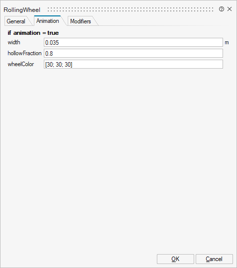

mo_width | width | Width of wheel | Scalar | |
mo_hollowFraction | hollowFraction | 1.0: Completely hollow, 0.0: rigid cylinder | Scalar | |
mo_wheelColor | wheelColor | Color of wheel | Vector of size 3 |

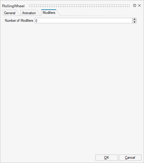

mo__modifiers/value | Value |
