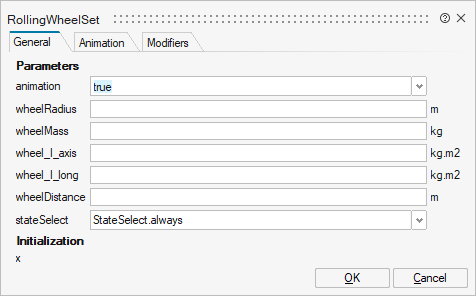

mo_animation | animation | = true, if animation of wheel set shall be enabled | Scalar | true |
mo_wheelRadius | wheelRadius | Radius of one wheel | Scalar | |
mo_wheelMass | wheelMass | Mass of one wheel | Scalar | |
mo_wheel_I_axis | wheel_I_axis | Inertia along one wheel axis | Scalar | |
mo_wheel_I_long | wheel_I_long | Inertia perpendicular to one wheel axis | Scalar | |
mo_wheelDistance | wheelDistance | Distance between the two wheels | Scalar | |
mo_stateSelect | stateSelect | Priority to use the generalized coordinates as states | Structure | |
mo_stateSelect/choice1 | StateSelect.never | Number | 0 | |
mo_stateSelect/choice2 | StateSelect.avoid | Number | 0 | |
mo_stateSelect/choice3 | StateSelect.default | Number | 0 | |
mo_stateSelect/choice4 | StateSelect.prefer | Number | 0 | |
mo_stateSelect/choice5 | StateSelect.always | Number | 0 | |

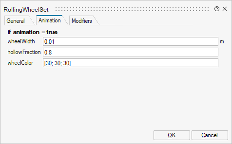

mo_wheelWidth | wheelWidth | Width of one wheel | Scalar | |
mo_hollowFraction | hollowFraction | 1.0: Completely hollow, 0.0: rigid cylinder | Scalar | |
mo_wheelColor | wheelColor | Color of wheels | Vector of size 3 |

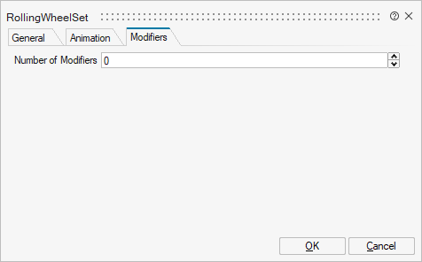

mo__modifiers/value | Value |
