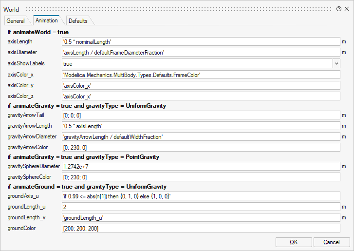

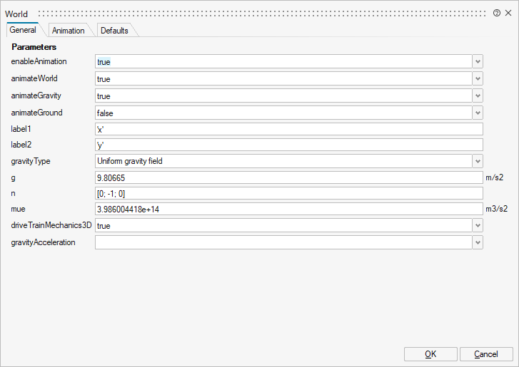

mo_enableAnimation | enableAnimation | = true, if animation of all components is enabled | Scalar | true |
mo_animateWorld | animateWorld | = true, if world coordinate system shall be visualized | Scalar | true |
mo_animateGravity | animateGravity | = true, if gravity field shall be visualized (acceleration vector or field center) | Scalar | true |
mo_animateGround | animateGround | = true, if ground plane shall be visualized | Scalar | true |

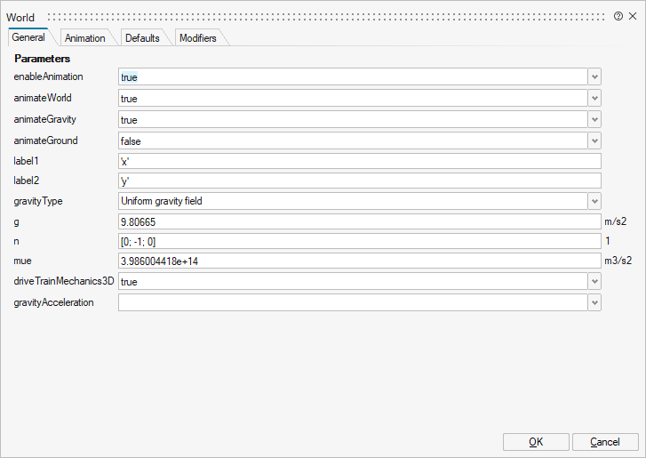

mo_label1 | label1 | Label of horizontal axis in icon | String | |
mo_label2 | label2 | Label of vertical axis in icon | String | |
mo_gravityType | gravityType | Type of gravity field | Structure | |
mo_gravityType/choice1 | No gravity field | Number | 0 | |
mo_gravityType/choice2 | Uniform gravity field | Number | 0 | |
mo_gravityType/choice3 | Point gravity field | Number | 0 | |
mo_g | g | Constant gravity acceleration | Scalar | |
mo_n | n | Direction of gravity resolved in world frame (gravity = g*n/length(n)) | Vector of size 3 | |
mo_mue | mue | Gravity field constant (default = field constant of earth) | Scalar | |
mo_driveTrainMechanics3D | driveTrainMechanics3D | = true, if 3-dim. mechanical effects of Parts.Mounting1D/Rotor1D/BevelGear1D shall be taken into account | Scalar | true |
mo_gravityAcceleration | gravityAcceleration | Function to compute the gravity acceleration, resolved in world frame | FromModelica('Modelica.Mechanics.MultiBody.Forces.Internal.standardGravityAcceleration') | |

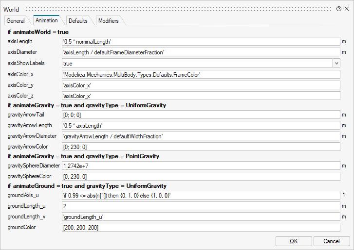

mo_axisLength | axisLength | Length of world axes arrows | Scalar | |
mo_axisDiameter | axisDiameter | Diameter of world axes arrows | Scalar | |
mo_axisShowLabels | axisShowLabels | = true, if labels shall be shown | Scalar | true |
mo_axisColor_x | axisColor_x | Color of x-arrow | Vector of size 3 | |
mo_axisColor_y | axisColor_y | Vector of size 3 | ||
mo_axisColor_z | axisColor_z | Color of z-arrow | Vector of size 3 | |
mo_gravityArrowTail | gravityArrowTail | Position vector from origin of world frame to arrow tail, resolved in world frame | Vector of size 3 | |
mo_gravityArrowLength | gravityArrowLength | Length of gravity arrow | Scalar | |
mo_gravityArrowDiameter | gravityArrowDiameter | Diameter of gravity arrow | Scalar | |
mo_gravityArrowColor | gravityArrowColor | Color of gravity arrow | Vector of size 3 | |
mo_gravitySphereDiameter | gravitySphereDiameter | Diameter of sphere representing gravity center (default = mean diameter of earth) | Scalar | |
mo_gravitySphereColor | gravitySphereColor | Color of gravity sphere | Vector of size 3 | |
mo_groundAxis_u | groundAxis_u | Vector along 1st axis (called u) of ground plane, resolved in world frame (should be perpendicular to gravity direction) | Vector of size 3 | |
mo_groundLength_u | groundLength_u | Length of ground plane along groundAxis_u | Scalar | |
mo_groundLength_v | groundLength_v | Length of ground plane perpendicular to groundAxis_u | Scalar | |
mo_groundColor | groundColor | Color of ground plane | Vector of size 3 |

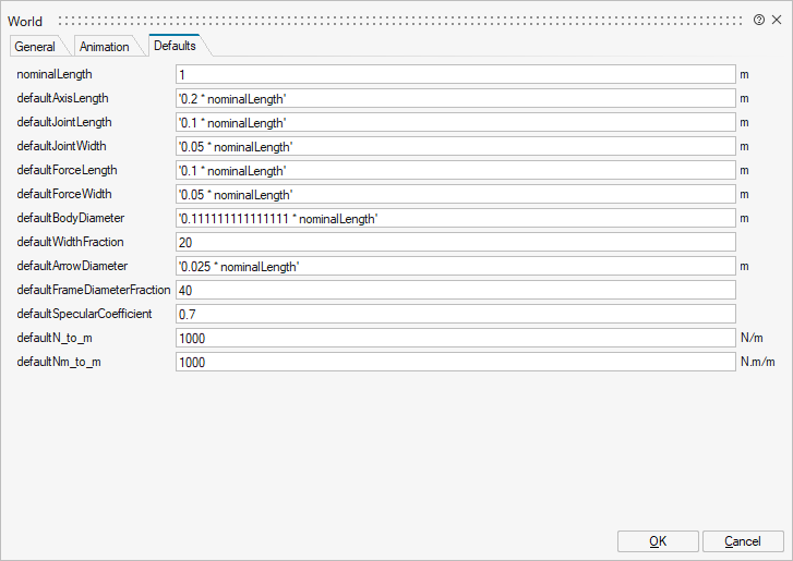

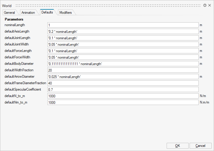

mo_nominalLength | nominalLength | "Nominal" length of multi-body system | Scalar | |
mo_defaultAxisLength | defaultAxisLength | Default for length of a frame axis (but not world frame) | Scalar | |
mo_defaultJointLength | defaultJointLength | Default for the fixed length of a shape representing a joint | Scalar | |
mo_defaultJointWidth | defaultJointWidth | Default for the fixed width of a shape representing a joint | Scalar | |
mo_defaultForceLength | defaultForceLength | Default for the fixed length of a shape representing a force (e.g., damper) | Scalar | |
mo_defaultForceWidth | defaultForceWidth | Default for the fixed width of a shape representing a force (e.g., spring, bushing) | Scalar | |
mo_defaultBodyDiameter | defaultBodyDiameter | Default for diameter of sphere representing the center of mass of a body | Scalar | |
mo_defaultWidthFraction | defaultWidthFraction | Default for shape width as a fraction of shape length (e.g., for Parts.FixedTranslation) | Scalar | |
mo_defaultArrowDiameter | defaultArrowDiameter | Default for arrow diameter (e.g., of forces, torques, sensors) | Scalar | |
mo_defaultFrameDiameterFraction | defaultFrameDiameterFraction | Default for arrow diameter of a coordinate system as a fraction of axis length | Scalar | |
mo_defaultSpecularCoefficient | defaultSpecularCoefficient | Default reflection of ambient light (= 0: light is completely absorbed) | Scalar | |
mo_defaultN_to_m | defaultN_to_m | Default scaling of force arrows (length = force/defaultN_to_m) | Scalar | |
mo_defaultNm_to_m | defaultNm_to_m | Default scaling of torque arrows (length = torque/defaultNm_to_m) | Scalar |

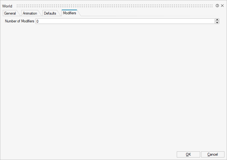

mo__modifiers/value | Value |
