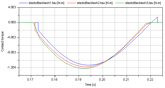

In the next figure, a typical simulation with the ElastoBacklash model is shown(Examples.Backlash)where the different effects are visualized:
- Curve 1 (elastoBacklash1.tau) is the unmodified contact torque, i.e., the linear spring/damper characteristic. A pulling/sticking torque is present at the end of the contact.
- Curve 2 (elastoBacklash2.tau) is the contact torque, where the torque is explicitly set to zero when pulling/sticking occurs. The contact torque is discontinuous at begin of contact.
- Curve 3 (elastoBacklash3.tau) is the ElastoBacklash model of this library. No discontinuity and no pulling/sticking occurs.

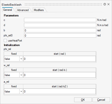

mo_c | c | Spring constant (c > 0 required) | Scalar | |
mo_d | d | Damping constant | Scalar | |
mo_b | b | Total backlash | Scalar | |
mo_phi_rel0 | phi_rel0 | Unstretched spring angle | Scalar | |
mo_bMax | bMax | Backlash in range bMin <= phi_rel - phi_rel0 <= bMax | Scalar | |
mo_bMin | bMin | Backlash in range bMin <= phi_rel - phi_rel0 <= bMax | Scalar | |
mo_phi_rel | phi_rel | phi_rel | Structure | |
mo_phi_rel/fixed | fixed | Cell of scalars | true | |
mo_phi_rel/start | start | Cell of scalars | ||

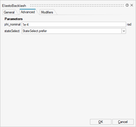

mo_phi_nominal | phi_nominal | Nominal value of phi_rel (used for scaling) | Scalar | |
mo_stateSelect | stateSelect | Priority to use phi_rel and w_rel as states | Structure | |
mo_stateSelect/choice1 | StateSelect.never | Number | 0 | |
mo_stateSelect/choice2 | StateSelect.avoid | Number | 0 | |
mo_stateSelect/choice3 | StateSelect.default | Number | 0 | |
mo_stateSelect/choice4 | StateSelect.prefer | Number | 0 | |
mo_stateSelect/choice5 | StateSelect.always | Number | 0 |

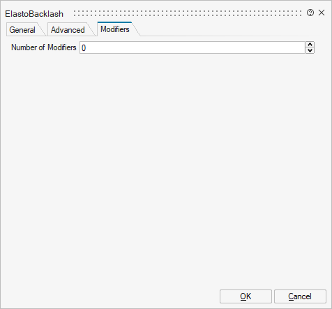

mo__modifiers/varname | Variable name | Cell of strings | 'tau' | |
mo__modifiers/value | Value |
