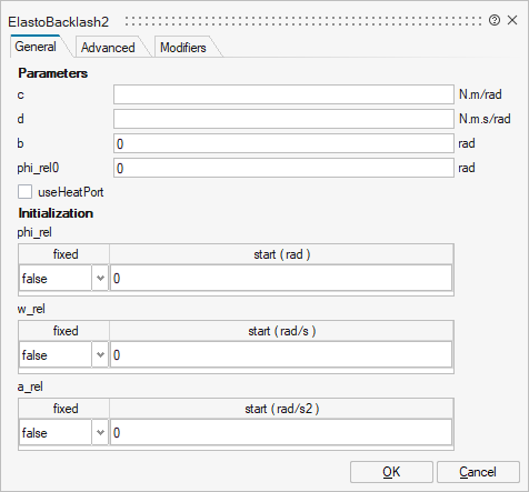

mo_c | c | Spring constant (c > 0 required) | Scalar | |
mo_d | d | Damping constant | Scalar | |
mo_b | b | Total backlash | Scalar | |
mo_phi_rel0 | phi_rel0 | Unstretched spring angle | Scalar | |
mo_bMax | bMax | Backlash in range bMin <= phi_rel - phi_rel0 <= bMax | Scalar | |
mo_bMin | bMin | Backlash in range bMin <= phi_rel - phi_rel0 <= bMax | Scalar | |
mo_phi_rel | phi_rel | phi_rel | Structure | |
mo_phi_rel/fixed | fixed | Cell of scalars | true | |
mo_phi_rel/start | start | Cell of scalars | ||
mo_w_rel | w_rel | w_rel | Structure | |
mo_w_rel/fixed | fixed | Cell of scalars | true | |
mo_w_rel/start | start | Cell of scalars | ||
mo_a_rel | a_rel | a_rel | Structure | |
mo_a_rel/fixed | fixed | Cell of scalars | true | |
mo_a_rel/start | start | Cell of scalars |

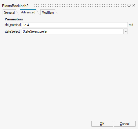

mo_phi_nominal | phi_nominal | Nominal value of phi_rel (used for scaling) | Scalar | |
mo_stateSelect | stateSelect | Priority to use phi_rel and w_rel as states | Structure | |
mo_stateSelect/choice1 | StateSelect.never | Number | 0 | |
mo_stateSelect/choice2 | StateSelect.avoid | Number | 0 | |
mo_stateSelect/choice3 | StateSelect.default | Number | 0 | |
mo_stateSelect/choice4 | StateSelect.prefer | Number | 0 | |
mo_stateSelect/choice5 | StateSelect.always | Number | 0 |

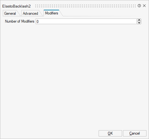

mo__modifiers/varname | Variable name | Cell of strings | 'tau' | |
mo__modifiers/value | Value |
