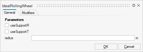

(flangeR.phi - internalSupportR.phi)*wheelRadius = (flangeT.s - internalSupportT.s);
mo_useSupportR | useSupportR | = true, if rotational support flange enabled, otherwise implicitly grounded | Number | 0 |
mo_useSupportT | useSupportT | = true, if translational support flange enabled, otherwise implicitly grounded | Number | 0 |
mo_radius | radius | Wheel radius | Scalar |
mo__modifiers/value | Value |
