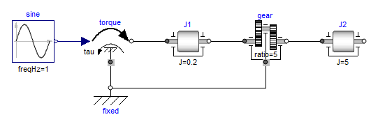

A simple example of the usage of this library is given in thefigure above. This drive consists of a shaft with inertia J1=0.2 whichis connected via an ideal gearbox with gear ratio=5 to a second shaftwith inertia J2=5. The left shaft is driven via an external,sinusoidal torque.The filled and non-filled grey squares at the left andright side of a component represent mechanical flanges.Drawing a line between such squares means that the correspondingflanges are rigidly attached to each other.By convention in this library, the connector characterized as afilled grey square is called flange_a and placed at theleft side of the component in the "design view" and the connectorcharacterized as a non-filled grey square is called flange_band placed at the right side of the component in the "design view".The two connectors are completely identical, with the onlyexception that the graphical layout is a little bit different in orderto distinguish them for easier access of the connector variables.For example, J1.flange_a.tau is the cut-torque in the connectorflange_a of component J1.
