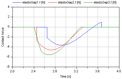

In the next figure, a typical simulation with the ElastoGap model is shown(Examples.ElastoGap)where the different effects are visualized:
- Curve 1 (elastoGap1.f) is the unmodified contact force, i.e., the linear spring/damper characteristic. A pulling/sticking force is present at the end of the contact.
- Curve 2 (elastoGap2.f) is the contact force, where the force is explicitly set to zero when pulling/sticking occurs. The contact force is discontinuous when contact starts.
- Curve 3 (elastoGap3.f) is the ElastoGap model of this library. No discontinuity and no pulling/sticking occurs.

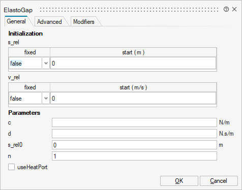

mo_s_rel | s_rel | s_rel | Structure | |
mo_s_rel/fixed | fixed | Cell of scalars | true | |
mo_s_rel/start | start | Cell of scalars | ||
mo_v_rel | v_rel | v_rel | Structure | |
mo_v_rel/fixed | fixed | Cell of scalars | true | |
mo_v_rel/start | start | Cell of scalars | ||
mo_c | c | Spring constant | Scalar | |
mo_d | d | Damping constant | Scalar | |
mo_s_rel0 | s_rel0 | Unstretched spring length | Scalar | |
mo_n | n | Exponent of spring force ( f_c = -c*|s_rel-s_rel0|^n ) | Scalar | |

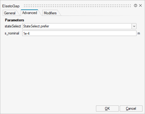

mo_stateSelect | stateSelect | Priority to use s_rel and v_rel as states | Structure | |
mo_stateSelect/choice1 | StateSelect.never | Number | 0 | |
mo_stateSelect/choice2 | StateSelect.avoid | Number | 0 | |
mo_stateSelect/choice3 | StateSelect.default | Number | 0 | |
mo_stateSelect/choice4 | StateSelect.prefer | Number | 0 | |
mo_stateSelect/choice5 | StateSelect.always | Number | 0 | |
mo_s_nominal | s_nominal | Nominal value of s_rel (used for scaling) | Scalar |

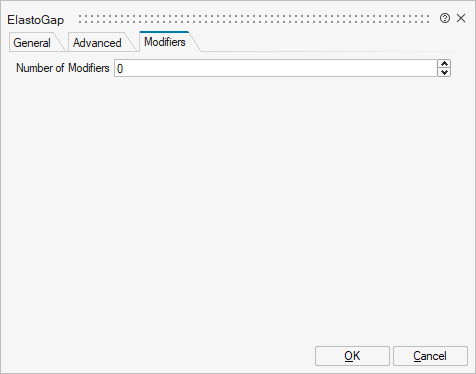

mo__modifiers/varname | Variable name | Cell of strings | 'f' | |
mo__modifiers/value | Value |
