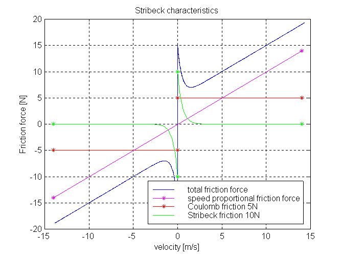

The surface is fixed and there is friction between sliding mass and surface.The frictional force f is given for positive velocity v by:
f = F_Coulomb + F_prop * v + F_Stribeck * exp (-fexp * v)
The distance between the left and the right connector is given by parameter L.The position of the center of gravity, coordinate s, is in the middle betweenthe two flanges.
There are hard stops at smax and smin, i. e. ifflange_a.s >= smin and flange_b.s <= xmax the sliding mass can move freely.
When the absolute velocity becomes zero, the sliding mass becomes stuck, i.e., the absolute position remains constant. In this phase thefriction force is calculated from a force balance due to the requirement that theabsolute acceleration shall be zero. The elements begin to slide when the frictionforce exceeds a threshold value, called the maximum static friction force, computed via:
maximum_static_friction = F_Coulomb + F_Stribeck

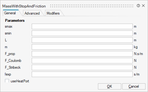

mo_smax | smax | Right stop for (right end of) sliding mass | Scalar | |
mo_smin | smin | Left stop for (left end of) sliding mass | Scalar | |
mo_L | L | Length of component, from left flange to right flange (= flange_b.s - flange_a.s) | Scalar | |
mo_m | m | Mass | Scalar | |
mo_F_prop | F_prop | Velocity dependent friction | Scalar | |
mo_F_Coulomb | F_Coulomb | Constant friction: Coulomb force | Scalar | |
mo_F_Stribeck | F_Stribeck | Stribeck effect | Scalar | |
mo_fexp | fexp | Exponential decay | Scalar | |

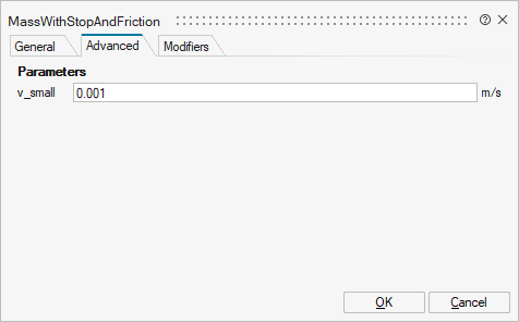

mo_v_small | v_small | Relative velocity near to zero (see model info text) | Scalar |
