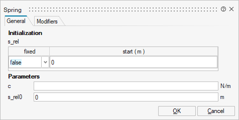

mo_s_rel | s_rel | s_rel | Structure | |
mo_s_rel/fixed | fixed | Cell of scalars | true | |
mo_s_rel/start | start | Cell of scalars | ||
mo_c | c | Spring constant | Scalar | |
mo_s_rel0 | s_rel0 | Unstretched spring length | Scalar |

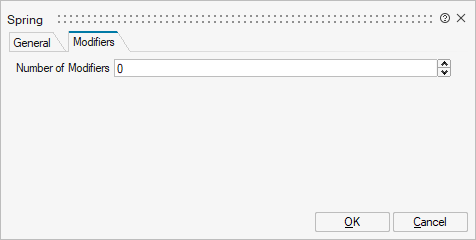

mo__modifiers/varname | Variable name | Cell of strings | 'f' | |
mo__modifiers/value | Value |
