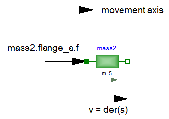

The equations of a mechanical component are vector equations, i.e.,they need to be expressed in a common coordinate system.Therefore, for a component a local axis of movement has to bedefined. All vector quantities, such as cut-forces orvelocities have to be expressed according to this definition.Examples for such a definition are given in the following figurefor a mass component:
As can be seen, all vectors are directed into the directionof the movement axis. The positions in the flanges are definedcorrespondingly.

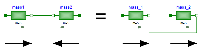

On first view, one may assume that the selected localcoordinate system has an influence on the usage of thecomponent. But this is not the case, as shown in the next figure:
In the figure the local axes of rotation of the componentsare shown. The connection of two masses in the left and in theright part of the figure are completely equivalent, i.e., the rightpart is just a different drawing of the left part. This is due to thefact, that by a connection, the two local coordinate systems aremade identical and the (automatically) generated connection equations(= positions are identical, cut-forces sum-up to zero) are alsoexpressed in this common coordinate system. Therefore, even if inthe left figure it seems to be that the velocity vector ofm2 goes from right to left, in reality it goes fromleft to right as shown in the right part of the figure, where thelocal coordinate systems are drawn such that they are aligned.Note, that the simple rule stated in section 4 (Sign conventions)also determines thatthe velocity of m2 in the left part of thefigure is directed from left to right.
To summarize, the local coordinate system selected for a componentis just necessary, in order that the equations of this componentare expressed correctly. The selection of the coordinate systemis arbitrary and has no influence on the usage of the component.Especially, the actual direction of, e.g., a cut-force is mosteasily determined by the rule of section 4. A more strict determinationby aligning coordinate systems and then using the vector directionof the local coordinate systems, often requires a re-drawing of thediagram and is therefore less convenient to use.
