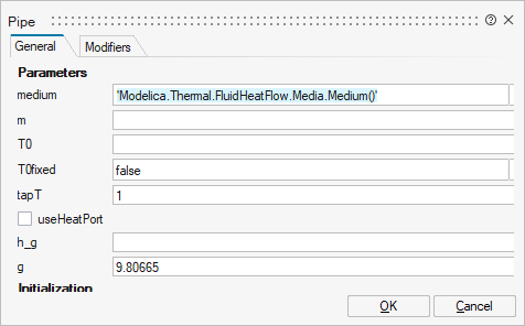

mo_medium | medium | Medium in the component | FromModelica('Modelica.Thermal.FluidHeatFlow.Media.Medium') | |
mo_m | m | Mass of medium | Scalar | |
mo_T0 | T0 | Initial temperature of medium | Scalar | |
mo_T0fixed | T0fixed | Initial temperature guess value or fixed | Scalar | true |
mo_tapT | tapT | Defines temperature of heatPort between inlet and outlet temperature | Scalar | |
mo_dpNomMin | dpNomMin | Scalar | ||
mo_k | k | Scalar | ||
mo_useHeatPort | useHeatPort | =true, if HeatPort is enabled | Number | 0 |
mo_h_g | h_g | Geodetic height (height difference from flowPort_a to flowPort_b) | Scalar | |
mo_g | g | Gravitation | Scalar | |

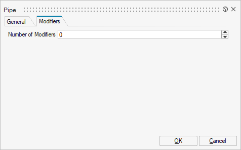

mo__modifiers/varname | Variable name | Cell of strings | 'dp' | |
mo__modifiers/value | Value |
