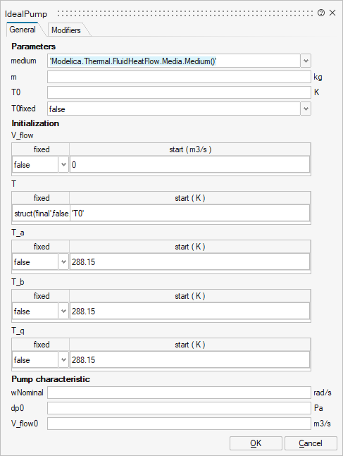

mo_medium | medium | Medium in the component | FromModelica('Modelica.Thermal.FluidHeatFlow.Media.Medium') | |
mo_m | m | Mass of medium | Scalar | |
mo_T0 | T0 | Initial temperature of medium | Scalar | |
mo_T0fixed | T0fixed | Initial temperature guess value or fixed | Scalar | true |
mo_tapT | tapT | Defines temperature of heatPort between inlet and outlet temperature | Scalar | |
mo_V_flow | V_flow | V_flow | Structure | |
mo_V_flow/fixed | fixed | Cell of scalars | true | |
mo_V_flow/start | start | Cell of scalars | ||
mo_T | T | T | Structure | |
mo_T/fixed | fixed | Cell of scalars | true | |
mo_T/start | start | Cell of scalars | ||
mo_T_a | T_a | T_a | Structure | |
mo_T_a/fixed | fixed | Cell of scalars | true | |
mo_T_a/start | start | Cell of scalars | ||
mo_T_b | T_b | T_b | Structure | |
mo_T_b/fixed | fixed | Cell of scalars | true | |
mo_T_b/start | start | Cell of scalars | ||
mo_T_q | T_q | T_q | Structure | |
mo_T_q/fixed | fixed | Cell of scalars | true | |
mo_T_q/start | start | Cell of scalars | ||
mo_h | h | h | Structure | |
mo_h/fixed | fixed | Cell of scalars | true | |
mo_h/start | start | Cell of scalars | ||
mo_wNominal | wNominal | Nominal speed | Scalar | |
mo_dp0 | dp0 | Max. pressure increase @ V_flow=0 | Scalar | |
mo_V_flow0 | V_flow0 | Max. volume flow rate @ dp=0 | Scalar |

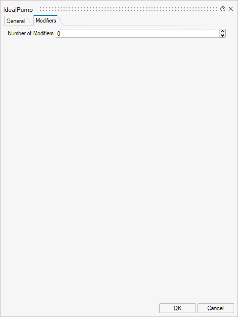

mo__modifiers/varname | Variable name | Cell of strings | 'dp' | |
mo__modifiers/value | Value |
