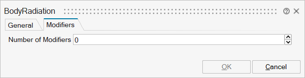

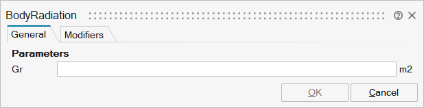

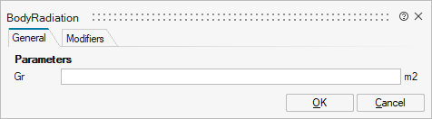

mo_Gr | Gr | Net radiation conductance between two surfaces (see docu) | Scalar |

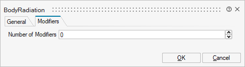

mo__modifiers/varname | Variable name | Cell of strings | 'Q_flow' | |
mo__modifiers/value | Value |
