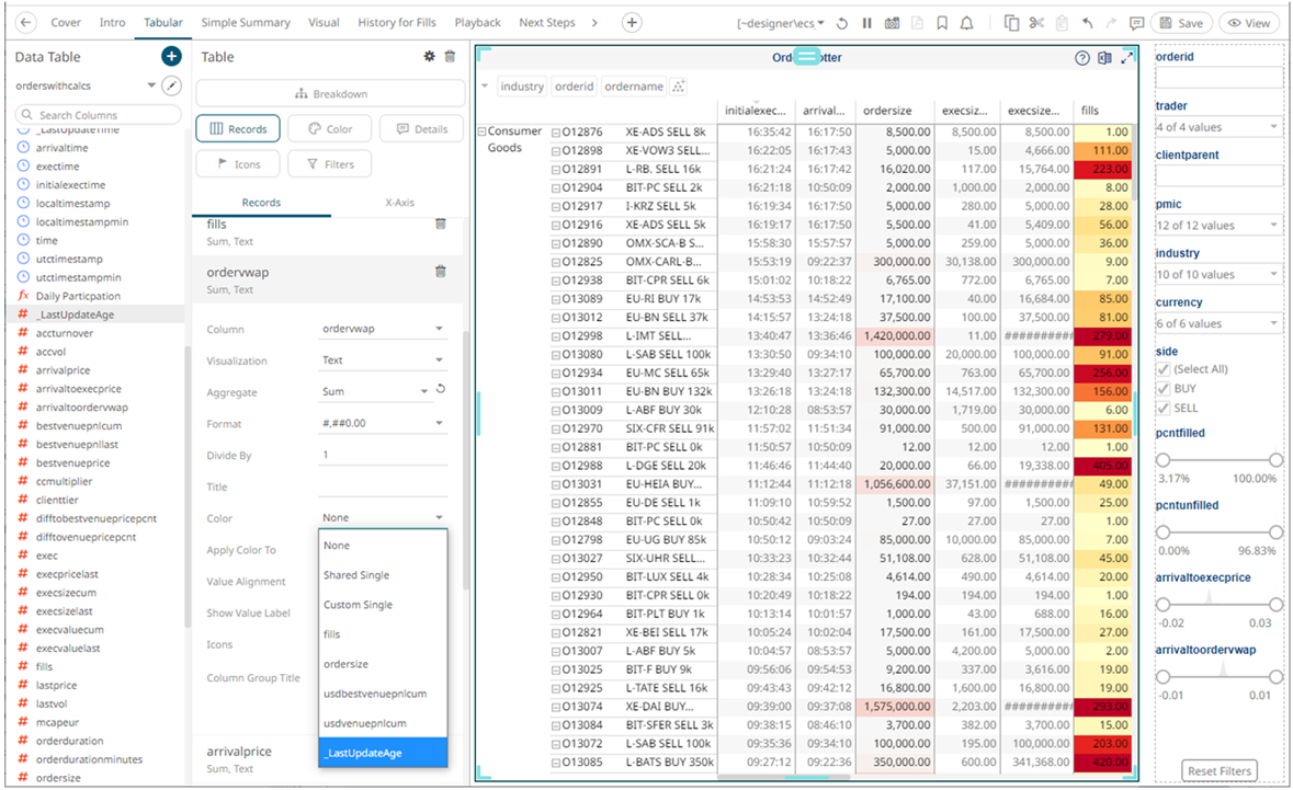

5.     Add a visualization and select the column/s that will have the color highlight.
Example:
In this Table visualization, the _LastUpdateAge column is added in the Color variable and will be used as the highlight for the overwrap record.

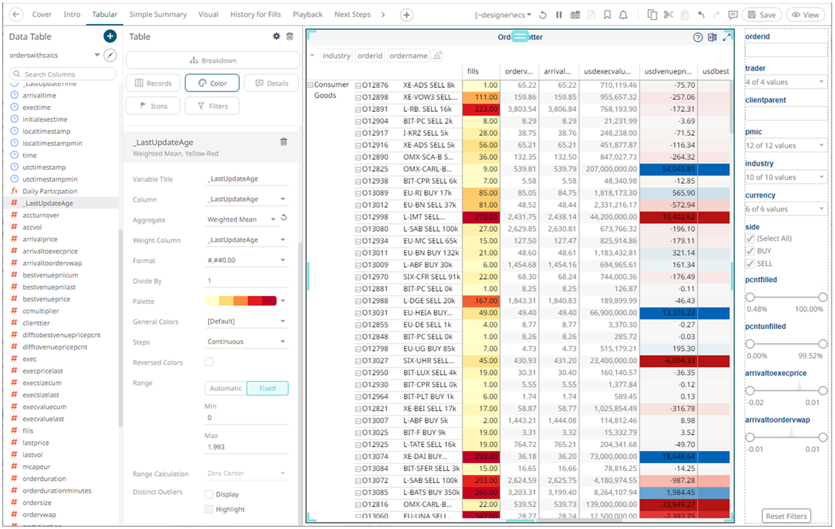

6.     To define the color settings, select _LastUpdateAge under the Color variable list.
In the example above the Range is 1 (Min) to 5 (Max) seconds with the color palette White-Red and the colors are Reversed. This means that when the _LastUpdateAge value is updated, the background color of the overwrap row will be red and will fade to white over the next 5 seconds.
You can then easily view whether the data is updated or stale.
