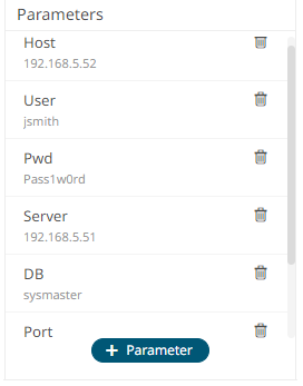

1.     On the Parameters pane of the Data Table Settings, define the connection settings you will use for the connector. Such as the following:
·         Host
·         User
·         Pwd
·         Server
·         DB
·         Port

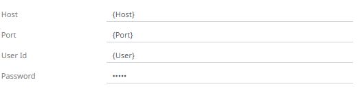

2.     Click on a data source. The Data Source Settings pane is displayed.
3.     Parameterize the entries in the pane.
For example:
