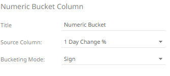

3.     Select the numeric Source Column.

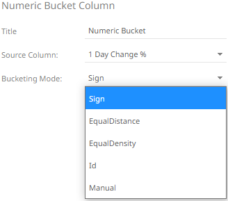

4.     Select Sign in the Bucketing Mode drop-down list box.

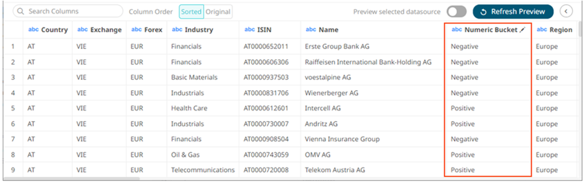

5.     Click . The new numeric sign bucket column is added and displayed in the Data Preview.
