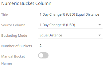

2.     Click New Column > Numeric Bucket.
The numeric bucket instance is displayed on the Data Sources Settings with Numeric Bucket as the default title, also the Numeric Bucket Column pane displays.
You may opt to modify the numeric equal distance bucket's Title.

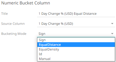

3.     Select the numeric Source Column.
4.     Select Equal Distance in the Bucketing Mode drop-down list box.
5.       Enter the Number of Buckets. This value can be parameterized.

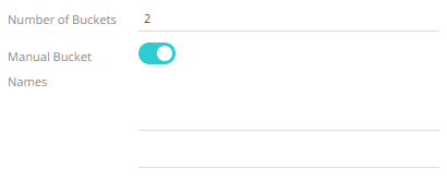

6.    Tap the Manual Bucket slider to turn it on.
The Names text box is enabled. For this example, 2 text boxes are available based on the specified Number of Buckets in step 5.
7.    Enter the bucket Names.

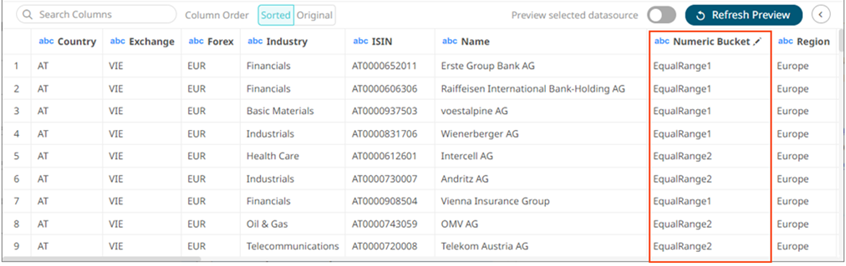

6.     Click . The new numeric equal distance bucket column is added and displayed in the Data Preview.

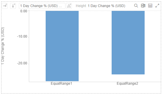

This new user defined column can be used in a visualizations breakdown to display data samples.
