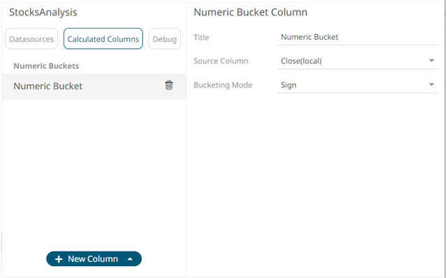

1.     On the Data Sources pane, click Calculated Columns.
The Calculated Columns pane displays.
2.     Click New Column > Numeric Bucket.
The numeric bucket instance is displayed on the Data Sources Settings with Numeric Bucket as the default title, also the Numeric Bucket Column pane displays.
You can modify the numeric manual bucket's Title.
3.     Select the numeric Source Column.

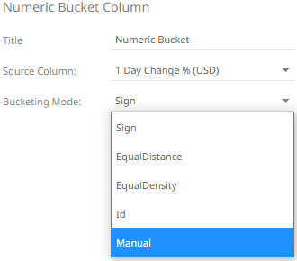

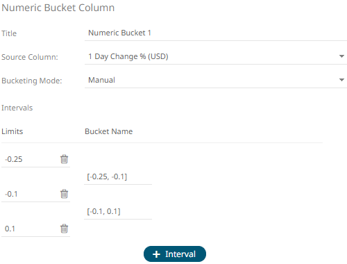

4.     Select Manual in the Bucketing Mode drop-down list box.
The Limits and Bucket Name fields are displayed.

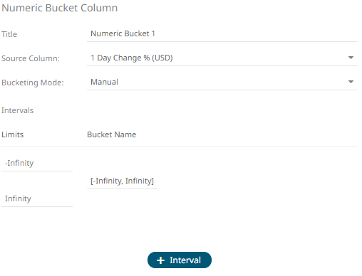

5.     Specify the customized limits of a bucket:

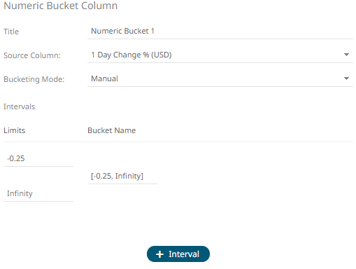

·         Enter the –Infinity value in the Limits box with the minimum limit value of the bucket.
This value is displayed in the Bucket Name box replacing the –Infinity value.
·         Enter the Infinity value in the Limits box with the maximum limit value of the bucket.
This value is displayed in the Bucket Name box replacing the Infinity value.
The range of the limits is now displayed in the Bucket Name box.

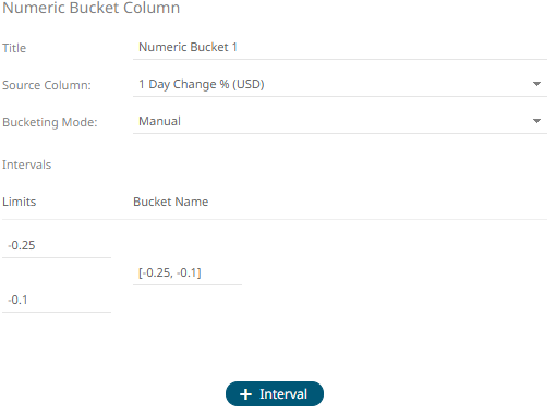

·         You can opt to modify the Bucket Name.

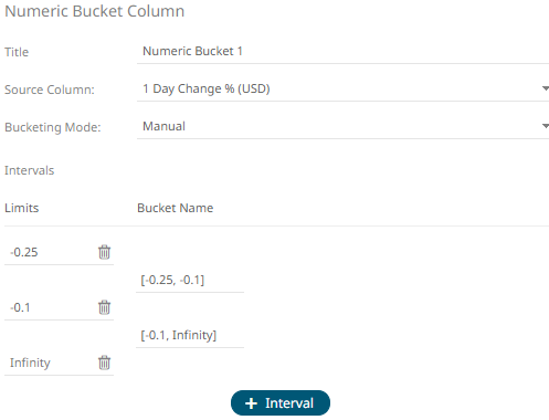

6.     To add more buckets, click .
Another bucket definition box is displayed.
Note that the preceding Infinity bucket value is now the minimum limit value of the new bucket.
7.     Replace the Infinity value in the Limits box with the maximum limit value of the new bucket.
To delete manual bucket range limits, click their corresponding  button. The Bucket Name value is adjusted based on the available limits.

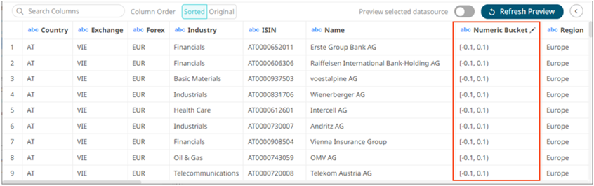

8.     After you are done adding buckets, click . The new numeric manual bucket column is added and displayed in the Data Preview.

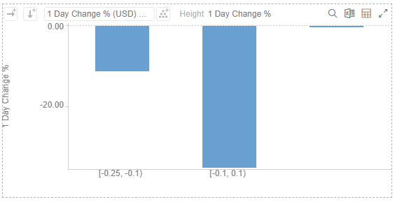

The new Manual bucket column will appear in the output data schema.
This new user defined column can be used in a visualizations breakdown to display data samples.
