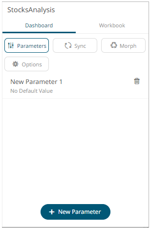

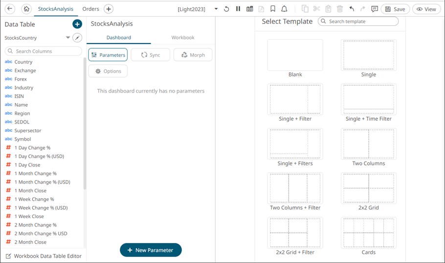

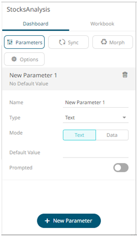

1.     On the Dashboard and Workbook Settings pane, click the Dashboard tab.
2.     Click .
A New Parameter instance is displayed.
3.     Click on this new instance.
4.     Enter the Name of the parameter then click .
5.     Select the data Type: Text, Numeric, or Time.

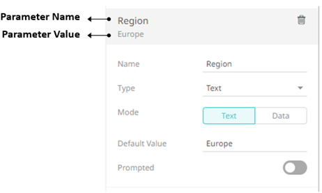

6.     Select the Mode: Text or Data
·         For the Text mode, enter the Default Value then click You can enter several default values, separated by a comma.

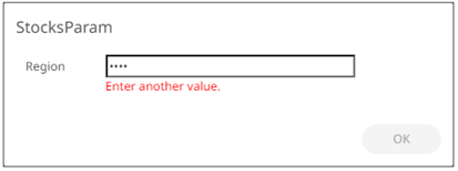

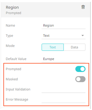

To prompt the parameter input when opening the workbook, tap the Prompted slider to turn it on. The dashboard parameter instance changes to allow specification of the following:
¨        To encrypt the value upon entry, tap the Masked slider to turn it on.
¨        Add a custom Input Validation. This can be any regular expression (e.g., “A-Z{3}”)
¨        The workbook will not be opened unless it passes the validation. Enter an Error Message to help in defining a better input to match the regular expression (e.g., “Enter another value.”)

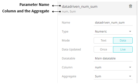

·         For the Data mode, the parameter is given a data-driven value either Once or Live.
Then select the Data Table, Column, and Aggregate.

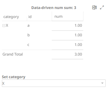

If Once is the selected Data mode, the parameter is given a data-driven value once, at workbook startup and open, but it is not repeated when the data table is refreshed.
The first time you open the workbook and X is the category, the parameter data-driven num sum is 3.
Changing the category to Y, the parameter datadriven_num_sum  is still 3.

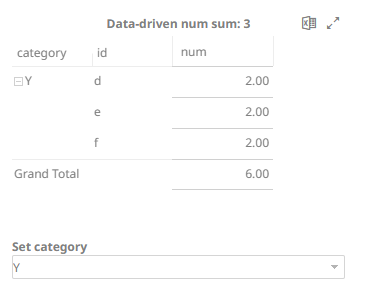

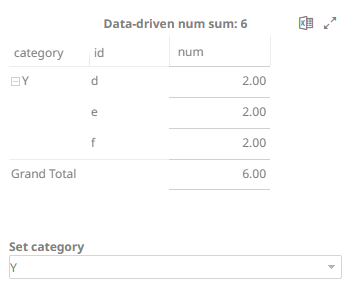

However, if Live is the selected Data mode, the data-driven parameter is updated “live” and kept in sync with the data value.
The first time you open the workbook and X is the category, the parameter datadriven_num_sum  is 3.
Changing the category to Y, the parameter datadriven_num_sum  is updated to 6.
