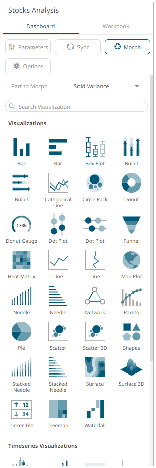

1.     On the Dashboard and Workbook Settings pane, click the Dashboard tab and then the  button.
The Morph pane displays.

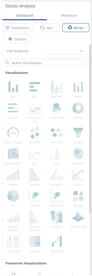

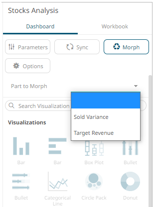

2.     Select the visualization to morph from the drop-down list.
The list of visualizations is enabled.
3.     Select another visualization on the list.
The visualization is changed to the new one.
