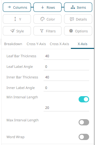

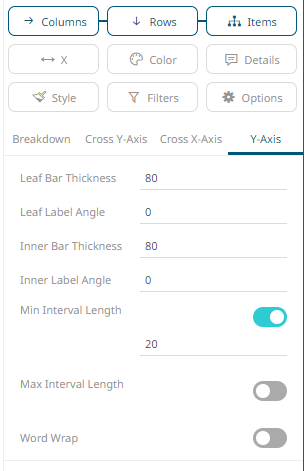

The X and Y axes of visualizations may include the following settings when accessed from the Breakdown section:
Setting
Leaf Bar Thickness
The thickness of the leaf or lowest level of data.
Leaf Label Angle
The Label angle of the leaf or lowest level of data of the crosstab axis. Default is 0, accepts values between -90 and +90.
Inner Bar Thickness
The width or height allocated for the non-leaf components of the crosstab axis in pixels. Default is 80.
Inner Label Angle
The angle of the non-leaf labels. Default is 0, accepts values between -90 and +90.
Min Interval Length
The minimal interval in pixels between cross tabbed visualizations. Default is 20.
Max Interval Length
The maximum interval in pixels between cross tabbed visualizations. Default is 400.
Word Wrap
Determines whether to wrap the visualization axis text.

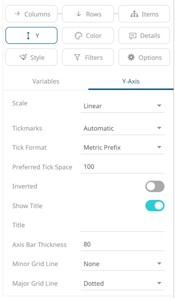

Some visualizations may also include the following X and Y axes settings:
Setting
Scale
Determines whether the scale of the axis is Linear, Log, or Power.
·         Linear – a change between two values is based on addition e.g., 30, 60, 90, 120, 180, etc.
·         Log - a change between two values is perceived based on the ratio of the two values or based on multiplication.
Once selected, the Base control displays the value of the common base for the logarithmic scale (i.e., 10).
For example: log10(x) represents the logarithm of x to the base 10 e.g., 1, 10, 100, 1000, etc.
You can opt to enter a new Base value then click .
NOTE: Value cannot be lower than 2.
·         Power – Works according to the SIGN(MEASURE)*LOG10(MAX(1, ABS(MEASURE))) formula. Works like the Log scale except it can handle negative values and every value between -1 and 1 is set to 0.
For example, for values between -100 and 100, the axis will be:
-100, -10, 0, 10, 100
Tickmarks
Determines whether the tick marks are set to Automatic, Fixed, or None.
·        Automatic – allows you to set the Tick Format and Preferred Tick Space values.
·        Fixed – allows you to set the tick mark’s Value and Label.
Click  to add more or  to delete.
·        None – no tick marks are set for the X or Y axis.
Tick Format
Set to From Variable to use the format string that is on the current variable displayed in the axis. Set to Metric Prefix to format the Tick labels in the numeric axes using the metric prefixes.
The preferred space in pixels between the minor grid lines across the axis.
Inverted
Determines whether the Y or Height axis (for Vertical) or X or Width axis (for Horizontal) is inverted.
Show Title
Displays an Axis Title label.
When enabled, you can opt to enter a custom Title for the axis which will override the title of the visualization variable.
Axis Bar Thickness
The margin in pixels for the axis. If set to zero, the axis is removed.
Minor Grid Line
How minor grid lines are drawn across the axis. Allowed values:
None
·         Dotted
·         Dashed
·         Solid
Major Grid Line
How major grid lines are drawn across the axis. Allowed values:
·         None
·         Dotted
·         Dashed
·         Solid
