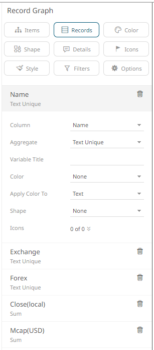

1.     To associate columns from the data table, drag and drop them to the Records variable drop area. Select a text column to display the corresponding configuration pane.
The name of the dragged column and its aggregate (e.g., Text Unique) are displayed as the header.
2.     You can opt to change the column to the be used as the Record variable from the Column drop-down list.
3.     Select the text aggregation method from the Aggregate field: Count Distinct, Text Unique (default), or Text Concat Distinct.
4.     Enter the label of the Record variable in the Variable Title field.
5.     Select the column that will be used as the Color in the Apply Color To field.
6.     Set how the color variable is displayed in the Apply Color To drop-down: Background,  Text, or Shape.

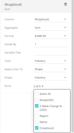

Sample 3. If Industry column is selected and the Apply Color To is set to Shape, then the visualization will be:
Displaying the shape is a useful visual cue in a record graph. Users will be able to build a legend that will display each unique combination of shape and color, along with the values from the columns used for the shape and color.
When selecting Shape as the Apply Color To value, ensure to select the Shape value in the drop-down list.
7.     Click the Icons drop-down and check the boxes of the columns with icons that will be assigned for this particular column.

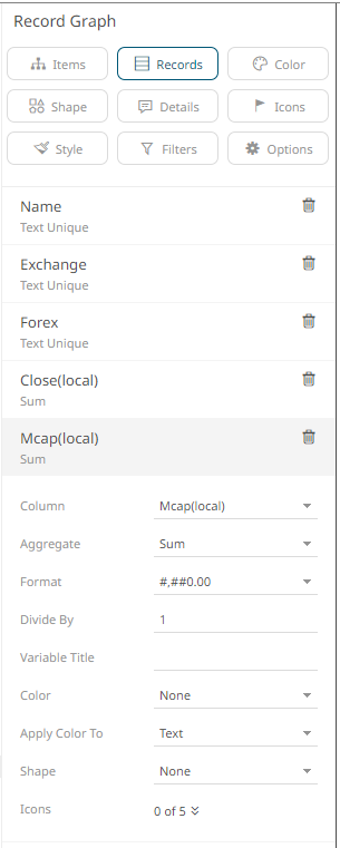

For numeric records, follow the steps below.
1.     Select a numeric column to display the corresponding configuration pane.
2.     You can opt to change the column to the be used as the Records variable from the Column drop-down list.
3.     Specify an aggregation method in the Aggregate field.
The default is Sum.
The Records variable also supports several other aggregate types.

4.     The Format field lets you specify the format that numbers will be displayed in. Panopticon uses the same formatting rules as Excel.
9.     Click the Icons drop-down and check the boxes of the columns with icons that will be assigned for this particular column.
